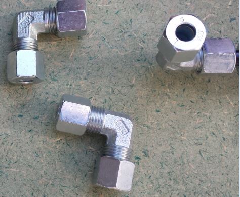

3 x Raccord bicône 8-8mm  3.90 € =  11.70 €
